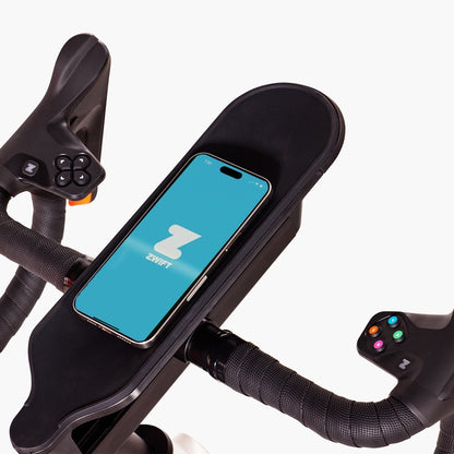

Styr med kontroller

Telefonbakke / holder

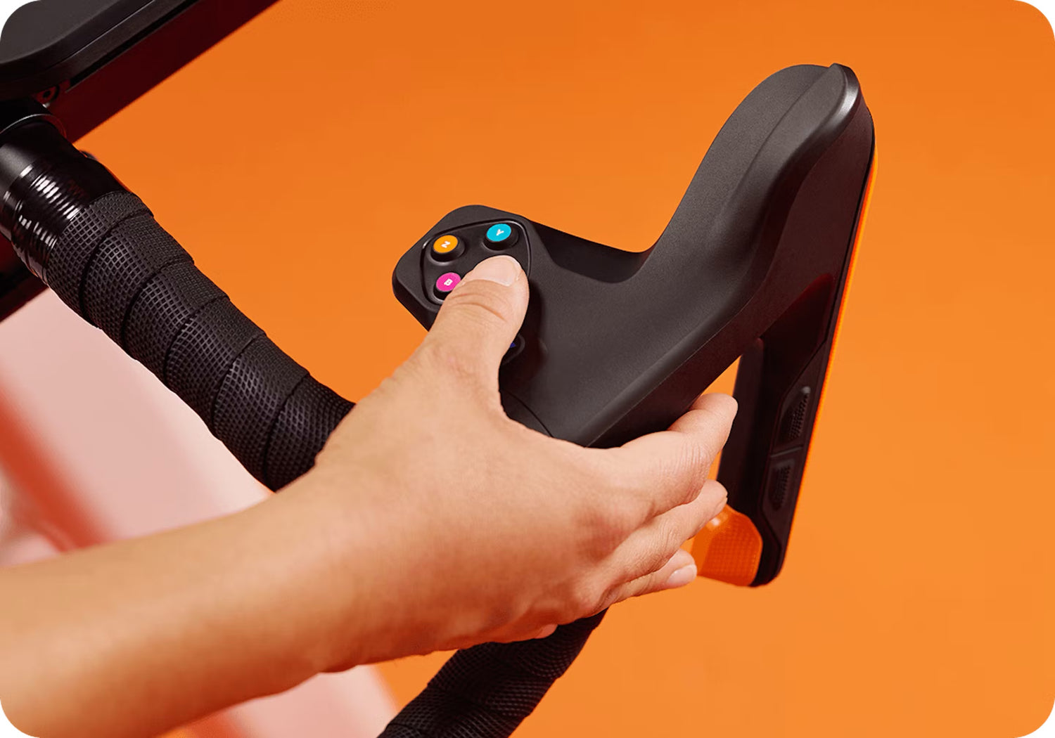

EFFORTLESS CONTROL
Control all of Zwift from your handlebars. Steer, use PowerUps, give a Ride On, and more.

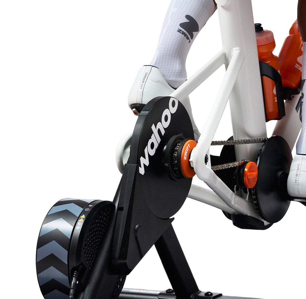

  • Close-up of a Wahoo smart trainer with Zwift cog, attached to a zwift frame on a white background
